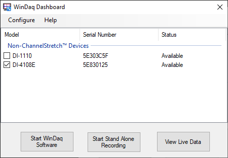

1. Go to the main WinDaq Dashboard window.
2. Select the device by clicking on the checkbox.
3. Go to Menu item Configure > Ethernet Settings > Assign IP Address and access the Network Configuration window.
4. Select Specify an IP address to set a static IP address.
5. Enter the appropriate IPv4 address (IPv6 is not supported) for all text boxes.
