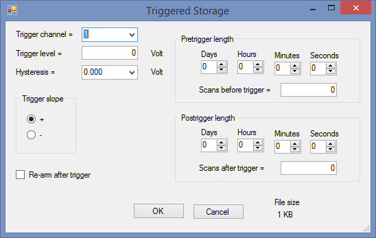

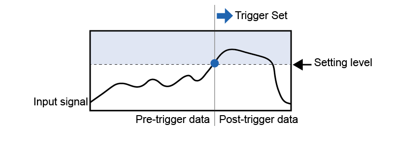

The triggered storage mode allows you to specify an analog channel level to begin recording. Triggered mode is not available when recording data to .CSV file format.
Click on the Configure button for options.
Trigger Channel
Select the analog input channel that will be your trigger channel.
Trigger Level
Enter the trigger level in Engineering Units you would like to start recording.
Hysteresis
Set hysteresis level to avoid multiple trigger events on noisy input signals. The hysteresis is set in Engineering Units based on the trigger channel.
Trigger Slope
Choose "+" if you would like to trigger on the signal in a positive direction.
Choose "-" if you would like to trigger on the signal in a negative direction.
Re-arm after trigger
Leave Auto Re-arm unchecked if you would like to run the trigger condition only once. Check "Re-arm after trigger" if you would like the device to automatically re-arm itself for another Start/Stop trigger cycle. Once a recording session has completed, a new trigger event will create a new file.

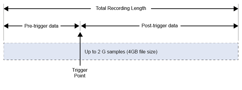

Pre-trigger and Post-trigger Length
Specify the amount of time or number of scans (each scan is one data point each of all enabled channels) to save to the file both before the trigger occurs and after.
Pre Trigger and Post Trigger data
WinDaq has a file size limit of 4GB. Each sample in a WinDaq file uses 2 bytes of storage.
Note: The data file will be saved to the thumb drive even if the trigger condition was not met. Look for an event marker in the WinDaq file. If there are none, then there was no trigger event as defined by trigger level.
