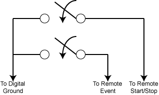

Proper
Connections
Use the following diagram for proper connection
of the remote control ports.
