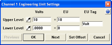

When selected, the Engineering Unit Settings dialog box is displayed:

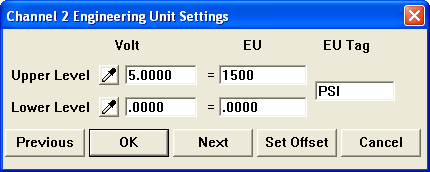

2.  When the relationship of volts to engineering units is known, define the relationship in the provided text boxes. For example, you know 5V equals 1500 PSI and 0V equals 0 PSI using your sensor. Enter the Volt and EU value in the appropriate text boxes:
3. Use the eyedroppers when you do not know the relationship of volts output from the sensor versus engineering units. Click either eyedropper to take a sample of the data in volts when a known engineering unit value is applied to the signal input or found at the cursor position for that channel. The sample value will appear in the volts dialog box. Enter the corresponding engineering units in the EU text box. Perform the same operation on the opposite end of the range. It is best to sample as close as possible to the upper and lower limits of your intended measurements to ensure accurate readings.
4.  Click OK to save the settings. Note that screen scaling for the adjusted channel may change, but can be redefined by selecting LIMITS... from the SCALING pull-down menu (see Scaling Limits or read instructions below). Click Next to save the settings and open the dialog box for the next channel. Click Previous to save the settings and open the dialog box for the previous channel. Cancel exits the box without saving any settings.

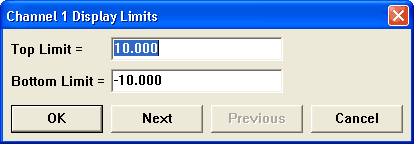

Specify convenient upper and lower chart edge values
  1. In the Scaling menu click on Limits…. This displays the Display Limits dialog box.
  1. Type convenient top and bottom chart-edge values in their respective text boxes.
  1. Click OK to complete the chart-edge value entry. Your specified values will now be displayed on the upper and lower chart-edges and the waveform will be automatically scaled to fit the new values.
