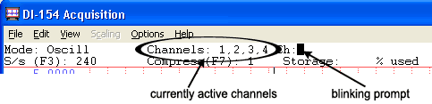

  1. In the Edit menu click on Channels.... The Ch: block cursor will blink in the Channels field on the status bar. The currently active list of enabled channels are displayed in this field, immediately to the left of the cursor (blinking prompt).
  1. Enter the desired channel number and press the ENTER key. Repeat for each desired channel. Each active channel will have its corresponding channel number displayed in the currently active channels list.
  1. When all desired channels have been enabled, exit the channel configuration routine by pressing any key other than the “D” or “I” key.
Channels may be disabled by typing the channel number preceded by a minus (“-”) sign. For example, typing “-3” disables channel 3 and removes it from the list of currently active channels.
Note: Channels may not be added after the RECORD mode has been entered.

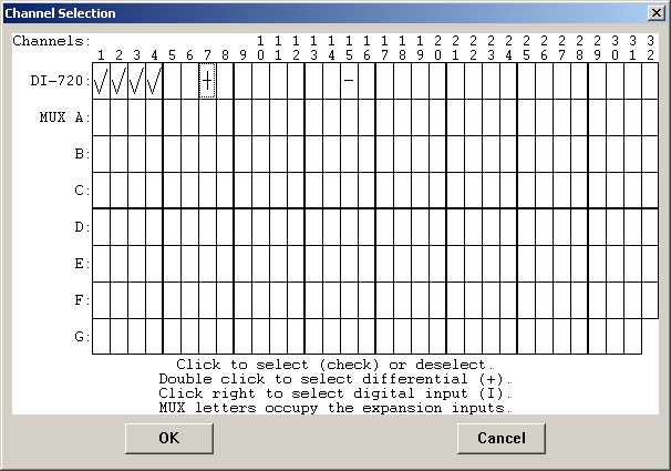

In the Edit menu click on Channels... or double-click on the Channels: field in the status bar. This displays the Channel Selection grid.
The current status of all channels is displayed in this grid. The Channel Selection grid allows the user to enable and disable channels. In the illustration above, the boxes formed by the top row of the grid represent the internal channels available on the hardware device (the corresponding channel number is positioned on top of the row). In this example, a DI-720 was used and configured for channels 1-4 as single-ended inputs and channel 7 as a differential input. The subsequent rows underneath the top row of the grid (labeled A, B, C, etc.) represent each group of 32 external analog input channels which may be activated through use of an analog channel expander (DI-725 or DI-75B).

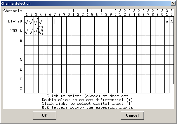

In the next graphic, a single DI-725 32-channel analog expander is added to the original DI-720. This allows Row A to be used to enable and disable channels on the analog expander. At the end of the row labeled DI-720, you’ll notice a pair of “A”s in the 31 and 32 positions. This indicates that the DI-725 is active and successfully communicating with the DI-720. It also indicates that channels 31 and 32 of the DI-720 are multiplexed through the DI-725. These channels on the DI-720 are, therefore, no longer available for direct input. Channel 31 multiplexes the first 16 channels or the attached channel expander and channel 32 multiplexes the next 16 channels. If a second expander is added, channels 29 and 30 would contain “B” indicating they are being used by the second expander. Each expander added continually increments channels in this manner.

Only pertains to internal [top row] analog inputs. Point to the box in the grid representing the desired channel and click the left mouse button. A checkmark will be displayed in the desired channel box, indicating that the channel has been enabled and designated as single-ended. Clicking on the left mouse button where a channel already has a check mark removes the checkmark and thus disables the channel. Enable fixed differential channels in the same manner. See your hardware manual to determine whether you instrument has fixed differential channels or not.
Enabling/disabling a differential channel
Point to the box in the grid representing the desired channel and double-click the left mouse button. A plus sign (+) will be displayed in the desired channel box, indicating that the channel has been enabled and designated as differential. Double-clicking a second time removes the plus sign and thus disables the channel.
Note that it is not possible to enable a differential channel numbered higher than one half the total number of channels provided by the device (assuming the device supports differential inputs). A differential channel requires two input terminals (positive and negative). For example, in order to designate channel 1 as differential requires both the channel 1 input terminal (positive input) and the channel 9 input terminal (negative input). For this same reason, when a differential channel is enabled, its corresponding input is marked with a minus sign (-) in the Channel Selection grid, indicating that it is the low input of the differential pair.
