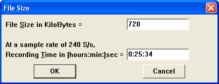

  1. In the File menu click on Record or press F4. This displays the Open File dialog box. Specify a file name to create a new file or open an existing file to append to it. If creating a new file, you will be prompted to specify a maximum file size. If appending to an existing file, you will be prompted to specify how much additional data to add to the existing file. In either case, you can specify file size in kilobytes or recording time. In the case of recording time, file size is based on the sample rate. Experiment with different file sizes, sample rates, and recording time to get the desired result. Move between the two text boxes with the mouse or TAB key. Entering information into the File Size box and pressing the TAB key will display the corresponding Recording Time in the Recording Time box and vice versa.
  1. Enter the desired file size or accept the default.
  1. Close the dialog box and begin recording by clicking OK or pressing the ENTER key.

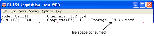

As data is being recorded to disk, the amount of file space consumed is displayed in the “Storage:” field of the status bar as a percentage of total file space consumed.
