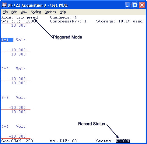

Note that the monitor does not display a waveform until the trigger condition is met. The following illustration shows a typical WinDaq Acquisition screen with acquisition triggering enabled, but no trigger as yet detected. It will remain like this until a trigger condition is detected. Note the Mode: field in the status bar displays Triggered and the Status: field in the bottom annotation line displays RECORD to indicate acquisition triggering is enabled.

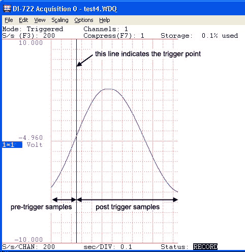

When a trigger condition is detected, the sample which met the trigger conditions (the trigger) is marked on the WinDaq Acquisition screen by a vertical line as shown below (if the Mark Trigger Point option is enabled). All points shown to the left of the vertical line (trigger) are the pre-trigger samples and all points shown to the right of the line are post-trigger samples.
If the screen is not large enough to show all desired pre- and post-trigger samples, only those around the trigger will be displayed, with the ratio of pre to post points the same as that requested in the Acquisition Triggering dialog box.

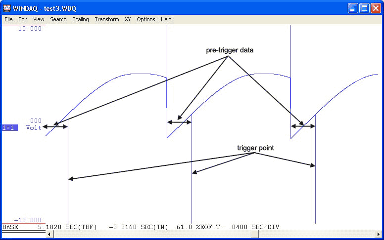

When reviewing the file in WinDaq Waveform Browser playback and analysis software, the start of the pre-trigger data is marked by a positive-going line (from the waveform to the top of the window) and the trigger point is marked by a negative-going line (from the waveform to the bottom of the window).
