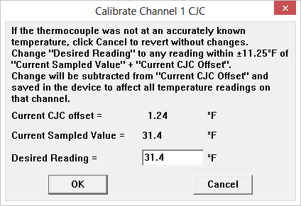

Opens the Calibrate CJC Dialog Box.

Assuming an ice bath, the measurement above should be 32. Change the Desired Reading text box to 32 and click OK. This procedure should be performed for every thermocouple channel.
