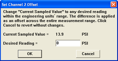

When Set Offset is clicked a dialog box will pop up allowing you to set the Offset. For example, when using a pressure sensor, you notice that when there is no pressure applied your reading is 13.9 PSI and you should apply an offset to your data.

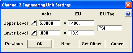

Go to the Engineering Unit Settings dialog box and click on the Set Offset button.

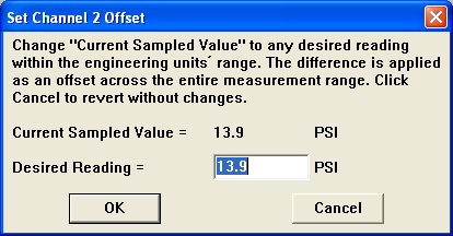

The Current Sampled Value is 13.9 PSI. To change this to 0 PSI edit the Desired Reading text box (enter 0 to force to zero).
Click OK to set your offset. Your upper and Lower EU values change to match your offset.
