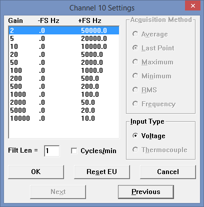

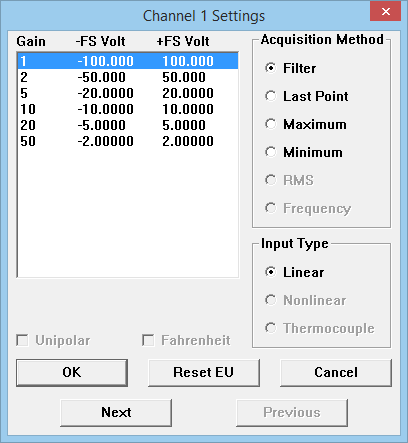

DI-4108 Channel Settings Gain Factors
The available gain settings are device-dependant. Choose the desired gain setting for that channel.
 Double-click on the desired gain factor (or click on the desired gain factor and then the OK button).
  Press the ↑ or ↓ arrow key until the desired gain factor is highlighted and press ENTER.
Gain Factors can also be set for the Rate channel.
DI-2008 Rate Channel Settings
Filter length values ("Filt Len") 1 through 64 affect the width of a moving window average for rate.
