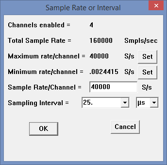

Enter the desired sample rate per channel in samples per second in the Sample Rate/Channel text box or select a sample interval in the Sampling Interval dropdown list. Click on one of the Set buttons to have WinDaq automatically set your per channel sample rate to the maximum or minimum allowed for your device.
Click OK or press the ENTER key.
The sample rate per channel is displayed in the lower left corner of the window as S/s/CHAN: (samples per second per channel).

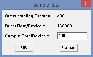

Setting Sample Rate for DI-2108-P Instruments
DI-2108-P sample rate
Enter the desired sample throughput rate per device in samples per second in the Sample Rate/Device text box. The burst rate per device is displayed because in Edit Channel Settings for frequency channel 10, the maximum +FS Hz value for the frequency range is half that value. The intelligent oversampling factor is displayed for informational purposes only.

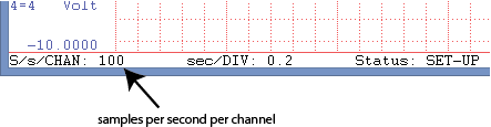

The sample rate per channel is calculated by taking the Sample Rate/Device and dividing by the number of enabled channels per device. For example, if you have one device connected with 4 enabled channels with a Sample Rate/ Device of 400 Hz, the samples per second per channel would be 100. The sample rate per channel is displayed in the lower left corner of the window as S/s/CHAN: (samples per second per channel).
Samples per second per channel for the DI-2108-P

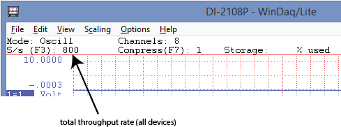

Total throughput rate is displayed in the top-left portion of the WinDaq screen at S/s (F3). For example, if two devices are connected and the Sample Rate/Device is 400 S/s would be 800.
DI-2108-P Throughput Rate
