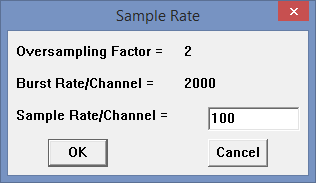

If only a single analog channel is enabled enter a Sample Rate/Channel.
Sample rate DI-2008

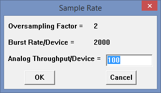

When 2 or more analog channels are enabled enter an Analog Throughput/Device.
Sample Rate DI-2008 Multiple Channels

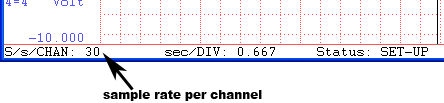

The sample rate per channel is displayed in the lower left corner of the window as S/s/CHAN: (samples per second per channel).

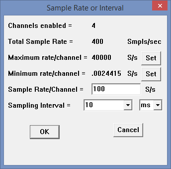

Sample rate or sampling interval
Enter the desired per channel sample rate in samples per second in the Sample Rate/Channel text box or select a sample interval in the Sampling Interval dropdown list. Click on one of the Set buttons to have WinDaq automatically set your per channel sample rate to the maximum or minimum allowed for your device.
