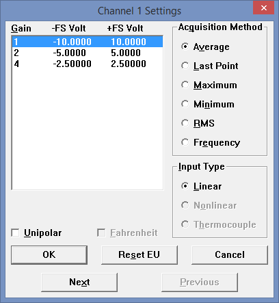

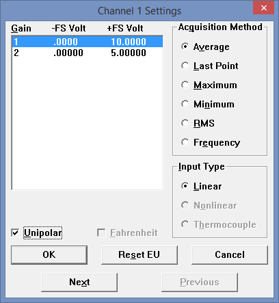

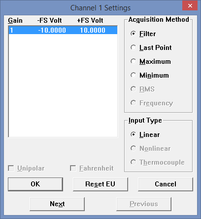

This displays the Channel Settings Dialog Box. The DI-2108 and DI-2108-P differ in gain settings.
DI-2108 Channel Settings dialog box:
DI-2108-P Channel Settings Dialog box:
Check the Unipolar checkbox for gain settings of 0-5 and 0-10V.
Choose the desired Acquisition Method for the selected channel.
Filter/Average
Default method. The DI-2108 employs a low-pass filter per analog channel with automatic corner frequency selection. The filter is a CIC (cascaded integrator comb) type that uses as many as 512 samples per channel to calculate in real time as data is acquired. Filter response is optimized when sampling frequency is set to ten times the highest frequency of interest. The DI-2108-P Average method averages all of the data points in the burst sample and reports this average as the single value for storage and display.
