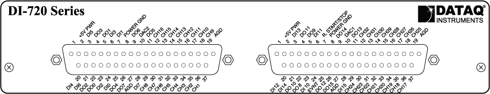

1. For the DI-720/722/730/740/750/760/785/788/500/510, "DigOut from High Byte" and "DigIn to Low byte" both connect to unlabeled expansion connector pins (via CABL-7, or the right front panel connector if available). Pins DI10 through DI15 go to data bits 2-7 of scanned data or DigitalInput return values, R. START/STOP goes to data bit 1, and EVNT goes to bit 0. Note the change in pinout with the following image.
