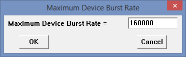

When Maximum Device Burst Rate is selected, a dialog box allowing you the enter a burst rate value displays.
Enter a value in the Maximum Device Burst Rate text box and click OK. Finding the most ideal burst rate is a matter of trial and error. Once an optimized burst rate is selected use the File > Save Default Setup command to save the value.
If "Device quit" messages occur frequently in a slow or busy computer, this value may be set lower than 120000 to limit Edit Preferences Maximum Sample Rate to the value entered divided by (number of channels enabled + 2).
