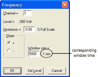

Edit Preferences Frequency... (ALT, E, P, Q).
The Frequency dialog box will display.
Channel = Sets the trigger channel.
Hysteresis = Sets the hysteresis level based on a percentage of the Full Scale. For example, assuming a Positive Full Scale value of 10 Volts - 1% is equal to 0.1 Volts. In this example, if your trigger level is set to 5 volts triggering will occur at 5.05 or 4.95 volts depending on the slope setting (positive (+) or negative (-)) and not again until the signal reaches the opposite rearm level. This prevents multiple triggering on a noisy slowly-moving transition.
Window size = The number of samples being calculated to display converted data. This should be set to at least as many samples as the maximum sample rate per channel (the maximum sample rate per channel is the maximum sample rate divided by the number of enabled channels) divided by the lowest expected input frequency. Increasing the window size results in a more stable signal but can average out speed variations that may be of interest. After setting this value, use the TAB key to display the corresponding window time.
A window size of 5000 samples with a time of .1 seconds would mean that 5000 samples at the device burst rate per channel on the selected channel, spread out over .1 seconds, are used to calculate each frequency value - i.e., if you have the maximum sample rate set at 50000 and 1 channel enabled, the software takes 5000 samples over .1 seconds (i.e., out of 5000 samples) and calculates one frequency data point. With each new data point acquired by your device, the window moves and the frequency is recalculated.

Note: Subsequently changing the sample rate or number of channels will change the corresponding window time.
The Slope radio button allows you to set the trigger condition on either a positive going slope (+) or a negative going slope (-).
The Trigger Level can be set by selecting Set Level. After selecting Set Level a level indicator appears in your acquisition window. This level indicator can be moved up and down to select the trigger level. The graphic below shows a trigger level setting of 5 Volts.
Although multiple frequency channels may be enabled using different gains, the trigger level and hysteresis for all of them must be the same relative to the full-scale dynamic range.
