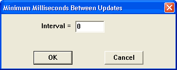

Specify a minimum screen update time.
 In the Preferences sub-menu click on Update Interval….
  Choose Edit Preferences Update Interval… (ALT, E, P, I).
This displays the Minimum Milliseconds Between Updates dialog box:
Enter in the text box the desired interval in milliseconds. When the desired interval is entered, click OK or press Enter to close the dialog box.
