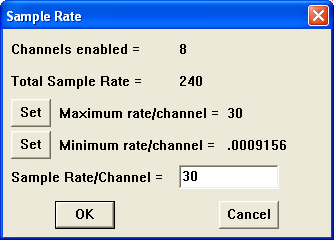

Specify a per channel sample rate:
  1. In the Edit menu click on Sample Rate.... This displays the sample rate dialog box:
  1. Enter the desired sample rate per channel in samples per second in the Sample Rate/Channel text box. Click on a Set button to have WinDaq automatically set your per channel sample rate to the maximum or minimum allowed for your throughput rate. Please Note: WinDaq/Lite will display a total sample throughput rate of 10,000 Hz (or 1250 Hz per channel) but will not record at rates over 240 Hz throughput (30 Hz per channel). You must purchase WinDaq/HS to record at rates over 240 Hz throughput.
  1. Click OK or press the ENTER key.

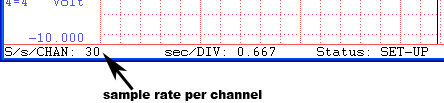

The sample rate per channel is displayed in the lower left corner of the window as S/s/CHAN: (samples per second per channel).

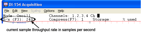

  1. Enter the desired data throughput rate (or total scanning rate) in samples per second in the Sample Rate text box.
WinDaq Acquisition automatically allocates the correct amount of buffer space when you input a sample rate. The Input Buffer Size and Disk Buffer Size values are displayed for informational purposes only.
Keep in mind that the sample rate is actually a throughput rate. The sample rate per channel (obtained by dividing the selected sample throughput rate by the number of channels enabled) is displayed in the lower left corner of the window as S/s/CHAN: (samples per second per channel).
