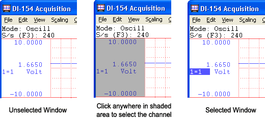

  1. Click the left mouse button in the unselected channel’s annotation margin to select an analog channel for gain adjustment. The focal point for selecting a channel for any type of adjustment is the variable waveform assignment indicator. This two-element equality (X=Y) is displayed for every enabled channel. Element “X” is the window number. Element “Y” is the analog channel assigned to that window. When selected, a box surrounds the variable waveform assignment indicator, indicating that the window is enabled for adjustment. When the desired channel is selected, gain adjustments to that channel are possible.

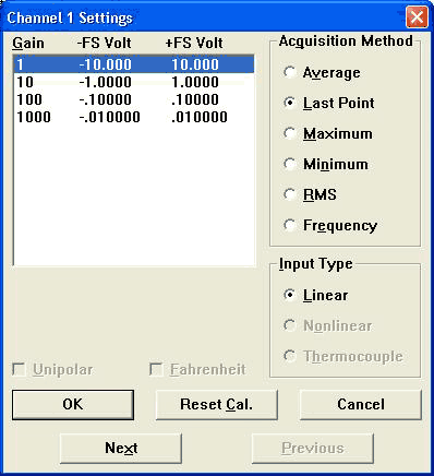

  1. In the Edit menu click on Channel Settings…. This displays the Channel Settings dialog box.
The gain factors you see displayed at the top of this dialog box are hardware dependent. Displayed next to each gain are the equivalent plus and minus full scale voltages that result from selecting that gain factor. These voltages vary by hardware device.
  1. Click on the desired gain factor.
  1. Click OK or press the ENTER key.
As the gain factor for a channel is sequenced upward and downward through gain ranges, ±full scale annotation adjusts to reflect the application of the various gain factors. A channel's gain factor cannot be adjusted following the initiation of data storage to disk. Only the SET-UP operating mode allows gain factor adjustments.
Channel Settings Dialog Box
See Channel Settings for complete details regarding channel settings.
