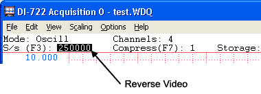

If the sample rate is displayed in reverse video when you attempt to acquire data to disk under Windows 98 or earlier, then you may not be able to reliably store data to disk. Refer to Different Ways of Allocating Memory for more details.
