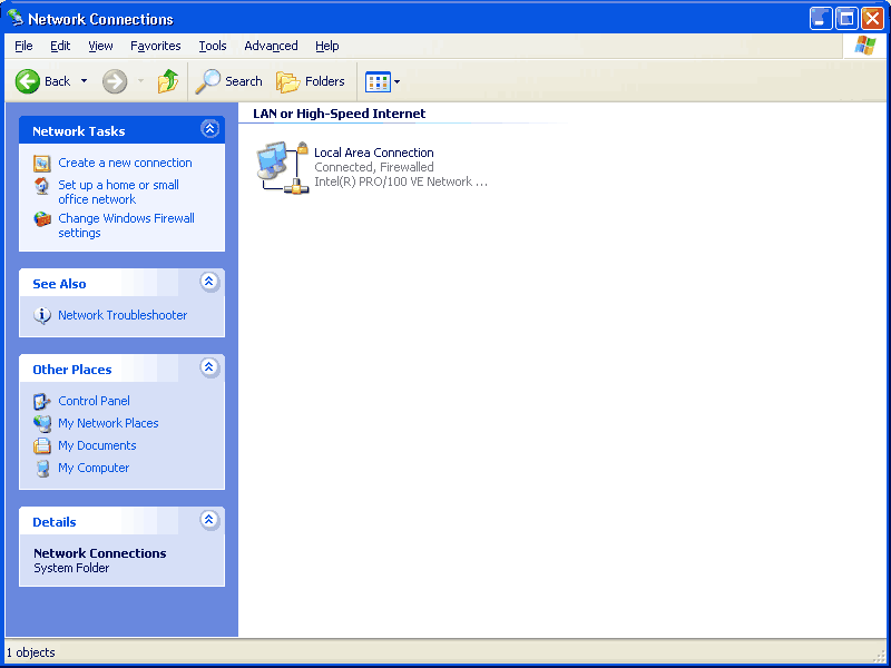

1. Find My Network Places in WindowsXP and find the Network Connections. Double-click on the Local Area Connection.

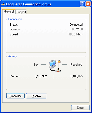

2. Click on the Properties button.

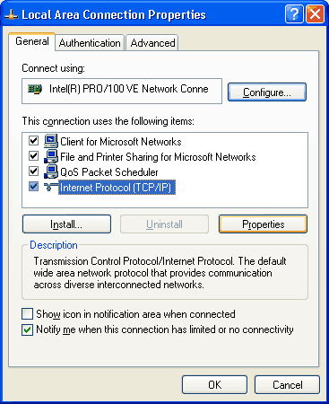

3. Select Internet Protocol (TCP/IP) and click on the Properties button.

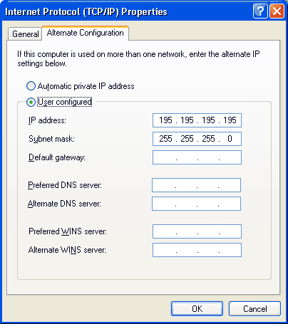

4. Select the Alternate Configuration Tab. Choose User configured and enter an IP address in the space provided. This will be the IP address of the Network Card. The Subnet mask should automatically be entered.
5. Click the OK button for the changes to take effect. Your instrument must have an IP address under your Subnet mask for the DATAQ Instruments Hardware Manager to see it in the Main Window. If the software does not see the device, change the IP address of the device using the instructions in Changing the IP Address of an Instrument Installed on a Static IP Network.
