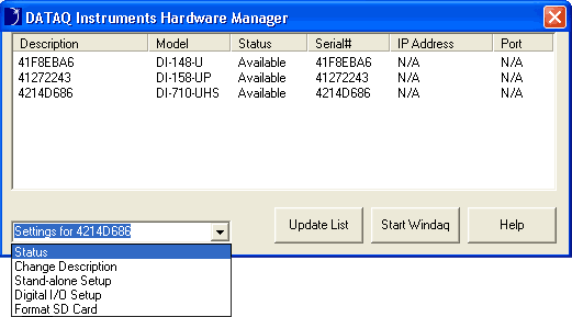

1. Highlight the device you would like to check the Status of.
2. Click on the Status command in the drop-down list. If the Status command does not show up in the command list then this feature is unavailable for the selected instrument.
3. The Status command will bring up the following informational box for your stand-alone data logger and the memory card inserted.
