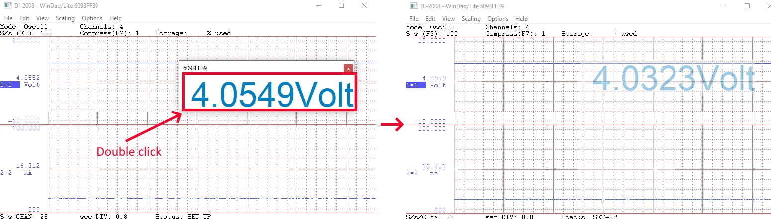

Once installed, launch the WinDaq Data acquisition software, and choose ‘Add-ons’ from the ‘View’ pull-down menu, and select ‘Magic Meter’ (View>>Add-ons>>Magic Meter).
Upon launching the Magic Meter add-on, you’ll see a meter display window containing the real-time value on channel 1 (the current highlighted channel).
Hover over the upper left-hand corner of the window to display the ‘Setting’ button (as shown below), and left-click on it.
Here you can choose the size of the meter window, change the color pallet and even select alarm levels, generating a visual alarm when signals rise above or fall below the thresholds entered.

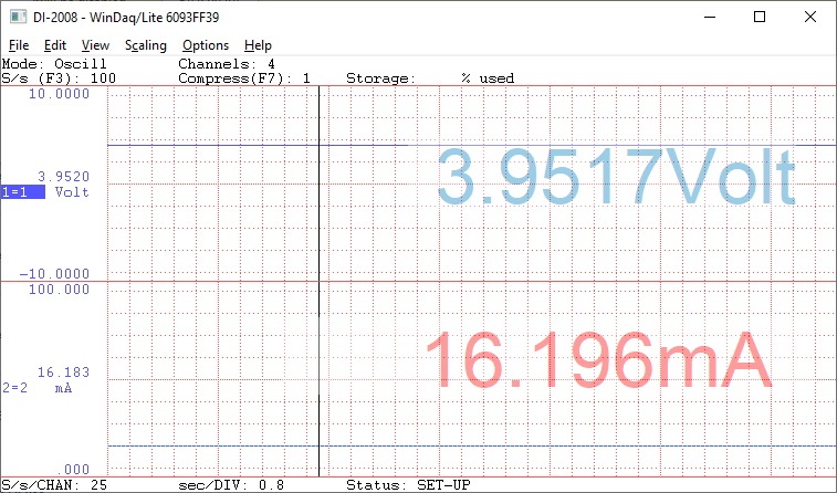

With Magic Meter configured, double click anywhere in the window to superimpose the live meter readout.
The Magic Meter add-on provides a clean, straight forward solution for those seeking a meter-style display in WinDaq.
