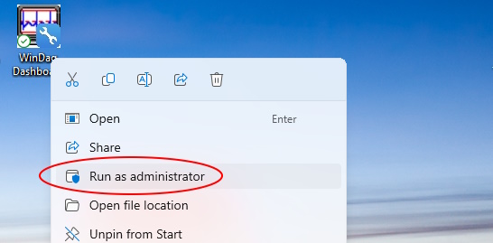

First, run the WinDaq Dashboard as an administrator.
To do so, right-click on the WinDaq Dashboard shortcut and choose ‘Run as administrator’.

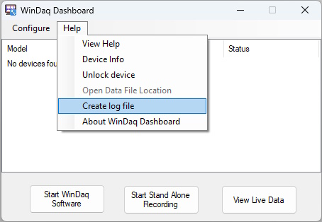

To create the dashboard.log file, with the data logger connected to your PC, select ‘Create log file’ from the ‘Help’ pull-down menu (as shown below).
Next, close the WinDaq Dashboard, and run it again.
Proceed as you normally would until the error occurs.
After the error or ‘No devices found’ message appears, retrieve the dashboard.log file from C:\Program Files (x86)\DATAQ Instruments\common.
