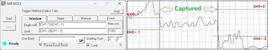

Two trigger conditions, one for start, another for stop. For example, with begin with CH0>1 until CH0>5 data will start to stream to Excel when the reading of first channel is above 1, and data will stop streaming to Excel when the reading of first channel is above 5

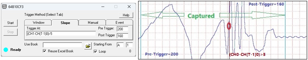

Single trigger point includes pre-trigger and post-trigger data, and the condition must go from false to true to be considered a trigger. For example, with trigger (CH0-CH[T-1]0)>5, pre trigger 200 and post trigger 160, the add-on will wait until the reading of first channel has a sudden positive jump greater than 5, before sending 200 rows before the trigger point and 160 rows after the trigger point to Excel

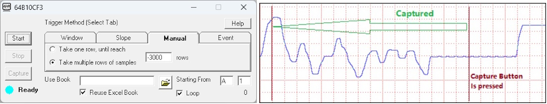

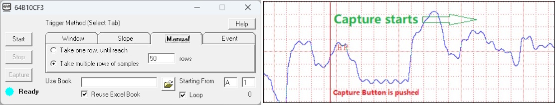

“Take multiple rows…”, each time Capture button is pressed, ExcelLink will begin to send defined rows of data to Excel if the rows is positive. If the row is negative, it captures defined number of abs(rows) up to the moment the button is pushed. For example below, it captures 3000 rows of data up the moment the button is pushed.

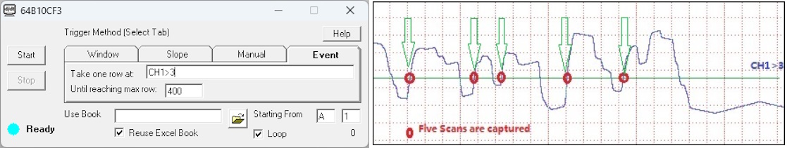

Single trigger point, when the test against the trigger condition goes from false to true, one row will be sent to Excel, until max row is met. For example, with CH0>3, each time the reading on first channel goes from below 3 to higher than 3, one row will be sent to Excel

Analog Derivative Trigger is powerful tool in data capturing. To demonstrate it, we look at a wavform swinging across the full range, we need to capture a glitch in the chart above, by using trigger condition (CH1-CH[T-1]1)>5, pre trigger 200 and post trigger 160, ExcelLink will wait until the reading of first channel has a sudden positive jump greate than 5, before sending 200 rows of data before the trigger point and 160 rows of data after the trigger point to Excel. Click here for more info.

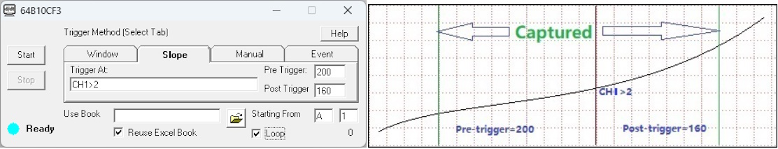

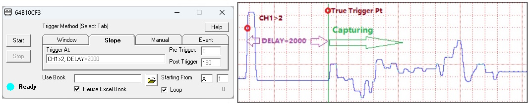

Delayed trigger is part of the Slope Trigger method, it adds delay to the trigger point. To use this feature, add the notation DELAY= after the trigger expreesion. After this notation, there are two formats available, First is to delay in terms of WinDaq sampling interval, which is accurated down to the sampling interval, add the number of interval directly, such as “CH1>2, DELAY=2000”. In this example, if WinDaq is sampling at 1ms sampling interval, the actually trigger point will be 2000 ms after channel 1 passes 2. Second is to delay in terms of second, which is calculated based on WinDaq sample rate, add the seconds with “SEC” at the end, such as “CH1>2, DELAY=2.3SEC”. In this example, if WinDaq is sampling at 0.5 second interval, the actual trigger point will be 2 seconds after channel 1 passes 2, since 2 seconds is the best this WinDaq configuration can do. Click here for more info
