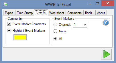

Specify event mark export and format with the Events tab.
Prerequisite to export Event Markers:
To export event markers, WinDaq file must be closed properly, meaning without side file with .WDE extension.
To confirm event maker is captured properly, please follow WWB->View->Event Markers... and you should see a report like this if real event markers exist
If you see a report that contains evenly distributed events, the WinDaq file has no real event markers
Comments
Select "Event Marker Comments" to include comments from commented event markers in the data export.
Select "Highlight Event Markers" to highlight the event marker cells in the Excel file. You may click on the color box to choose the highlight color.
Event Markers
Use the "Channel" radio button and drop-down box to specify which channel's event markers you would like to include in the export.
Use the "None" radio button to exclude event markers.
Use the "All" radio button to include all event markers.
These options are saved in the program for the next time you access the WWB to Excel utility.
