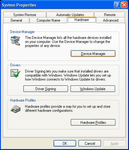

click on image to enlarge - Depending on which Operating System is running on your machine:
- Windows 98 and Windows ME - Click on the Device Manager tab.
- Windows 2000 and Windows XP - Click on the Hardware tab, then click on the Device.

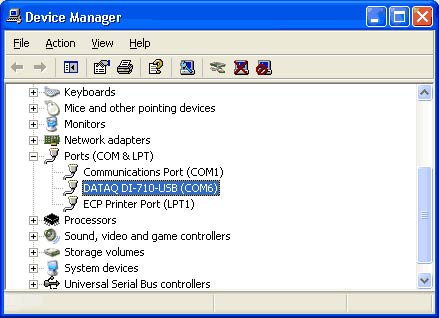

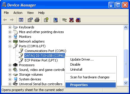

- Find Ports (COM & LPT) and expand by clicking the + box to the left. This shows all COM and LPT ports currently assigned on your computer.
- Find DATAQ DIxxx (COM#) - # is the COM port designated for your device.
click on image to enlarge - Change the COM port Number of your Device.
- Right-click on DATAQ DIxxx (COM#).
- Click on Properties.

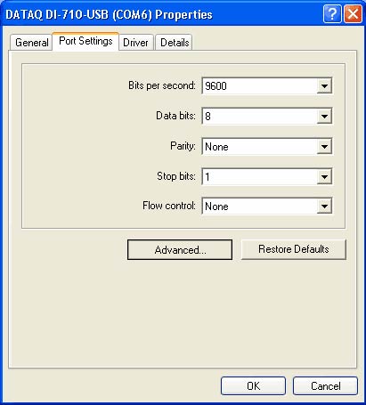

click on image to enlarge - Click on the Port Settings tab.
- Click on the Advanced button.

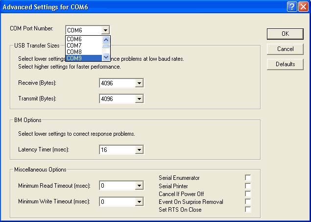

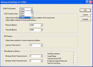

click on image to enlarge - Click the down arrow on the COM Port Number drop-down menu.
- Select an alternate COM port number.
