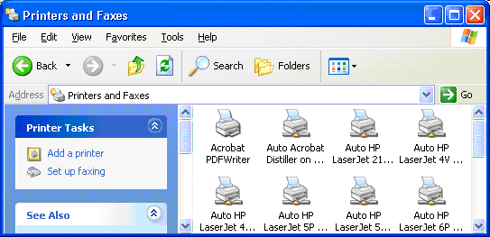

- Double-click on "Printers and Faxes" in the Windows "Control Panel"
- Select "Add a printer" from the "Printer Tasks" menu

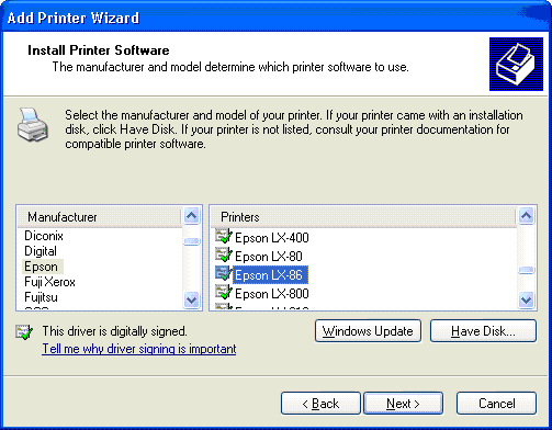

click on image to enlarge - Follow the "Add Printer Wizard" prompts and select the Epson LX-86 printer from the "Install Printer Software" dialog box
click on image to enlarge - Continue as prompted until installation is complete (don't leave the Epson LX-86 as the default printer)
- Reinstall WinDaq into the same folder and reboot the PC
