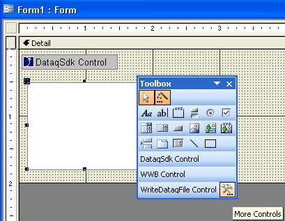

How do I add DATAQ ActiveX controls to my Access 2003 database?
STEP 1: Insert a Macro, Module, Form, etc. into your database project.
Click Insert>>Module or click Insert>>Form
If you insert a module, the Visual Basic Editor will automatically open and you can begin writing custom code into the module.
If you insert a form and choose Design Mode, you can design your form in the same window as your database.
STEP 2: From the Form, add the DATAQ ActiveX controls to your project by clicking the More Controls button in the toolbox (see above). To add the controls into the toolbox for later use, right click inside the toolbox and click Customize.
